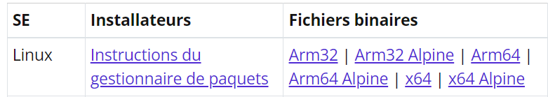

I searched and understood that I need to install the .NET SDK. But i don’t have root nor sudo so I can’t run this:
sudo apt-get install -y dotnet-sdk-7.0
I found instructions to install it manually here (sorry, in French):
But, it refers to version 9.0: do I need version 7.0?
And how can I choose the binary file?
