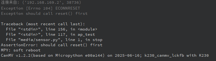

我根据 Taoxuan-168的代码改了一下,是通过AP模式发送视频流,但是程序报错,手机连接热点后浏览器无法打开网址,请大佬帮忙看一下,谢谢。

    try:
        # 接受连接
        client, addr = s.accept()
        print(f"连接来自: {addr}")
        client.send("HTTP/1.1 200 OK\r\n"
                     "Server: Yang\r\n"
                     "Content-Type: multipart/x-mixed-replace;boundary=Yang\r\n"
                     "Cache-Control: no-cache\r\n"
                     "Pragma: no-cache\r\n\r\n".encode())
    except socket.timeout:
        print("等待客户端连接超时")
    finally:
        s.close()
        try:
                # 捕获图像
                img = sensor.snapshot(chn=CAM_CHN_ID_0)
                # 显示捕获的图像,中心对齐,居中显示
                Display.show_image(img)
                # 转为 JPEG 格式,默认 quality=50~90 可调
                imge = img.to_jpeg()
                header = "--Yang\r\n" \
                   "Content-Type: image/jpeg\r\n" \
                   f"Content-Length: {len(imge)}\r\n\r\n"
                client.send(header.encode())
                client.send(imge)
        except KeyboardInterrupt as e:
              print("user stop: ", e)
        except BaseException as e:
              print(f"Exception {e}")
        finally:
            # sensor stop run
            if isinstance(sensor, Sensor):
                sensor.stop()
            # deinit display
            Display.deinit()
            os.exitpoint(os.EXITPOINT_ENABLE_SLEEP)
            time.sleep_ms(100)
            # release media buffer
            MediaManager.deinit()
